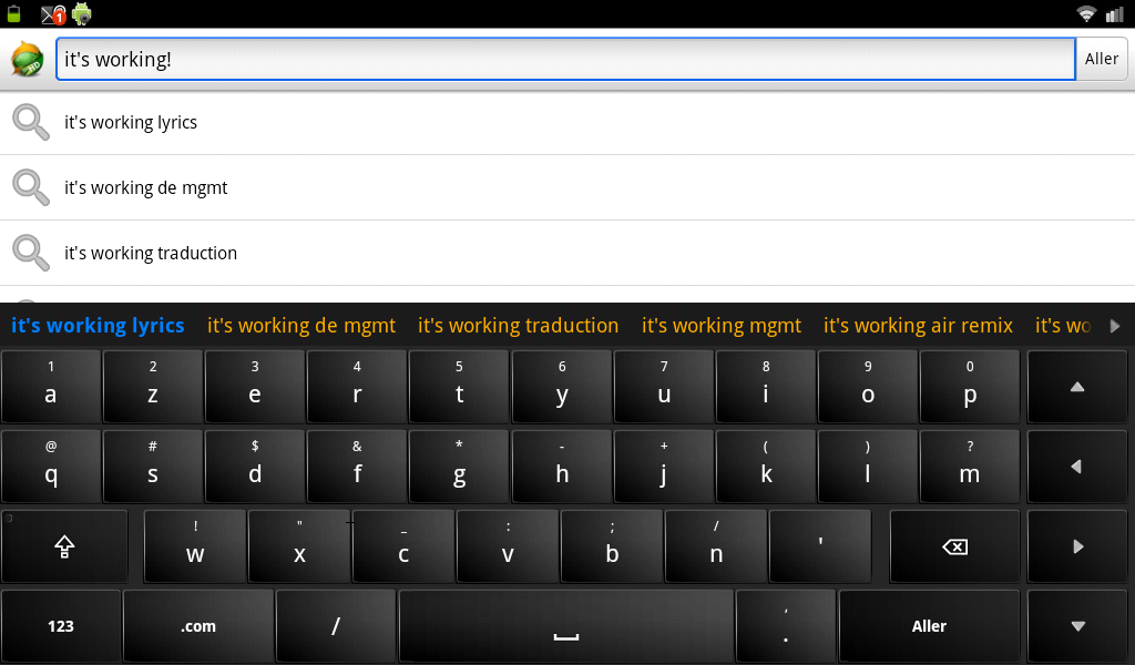

I'm trying to edit an existing theme, 3DKey, and I cannot get it to work after adding in the part to get the prediction bar to change. Every time I edit the xml, the skin becomes all black. Can anyone help?
Can you post your new skin? If it becomes black it means you made a mistake with images, or you found a bug
Here it is.
It also did the same thing when I changed the file names to colors, the same colors of the background.
So it's normal it doesn't work, as the images you used for the prediction bar (at least the background image is not a valid 9-patch image, it doesn't even have a 1-pixel border)
Right, they're .9 :/ why don't colors work in that field instead of a filename? I tried putting in a hex color but it didn't work either.
I didn't try actually, but colors instead of an image should work exactly like for the keyboard background (it's exactly the same code handling both)
i confirm. i updated my honeycomb skin with a gradient for the prediction bar, it works like a charm
Sent from my Adam using Tapatalk
I tried colors, it didn't work. Could you take a look at the skin.xml? See what I did wrong? It'd be SO appreciated!
Got it... your picture is not a 9patch (.9.png), it's a simple PNG file with 1x1px size.
If you want to use a colour, try this way :
Calling your file .9.png is not enough. Have a look at this page for more explanations
<color-top>#FF1b1b1b</color-top>
<color-bottom>#FF1b1b1b</color-bottom> instead of your picture. It should solve your problem. Calling your file .9.png is not enough. Have a look at this page for more explanations
I know, the .9 was a stupid mistake :/ thanks though!
I tried to fix the xml, but it still doesn't work. Attached.
Haloruler64 wrote:I know, the .9 was a stupid mistake :/ thanks though!Here it is, working
3D.zip 64.5 KB · downloaded 740 times
I wrote the modification I told you in the XML, compressed once more, sent to my tablet, and... ta-daaaa!
Thank you SO much! It's highly appreciated!
What did I do wrong in my xml? I can't tell.
i'm not an expert, but i guess the <color> tag you used is not supported. in the xml i gave back to you, i'm using a gradient -as you did in your background- with the same color for the top and the bottom. you can use a .9.png picture too, but don't forget the expand marks on it
